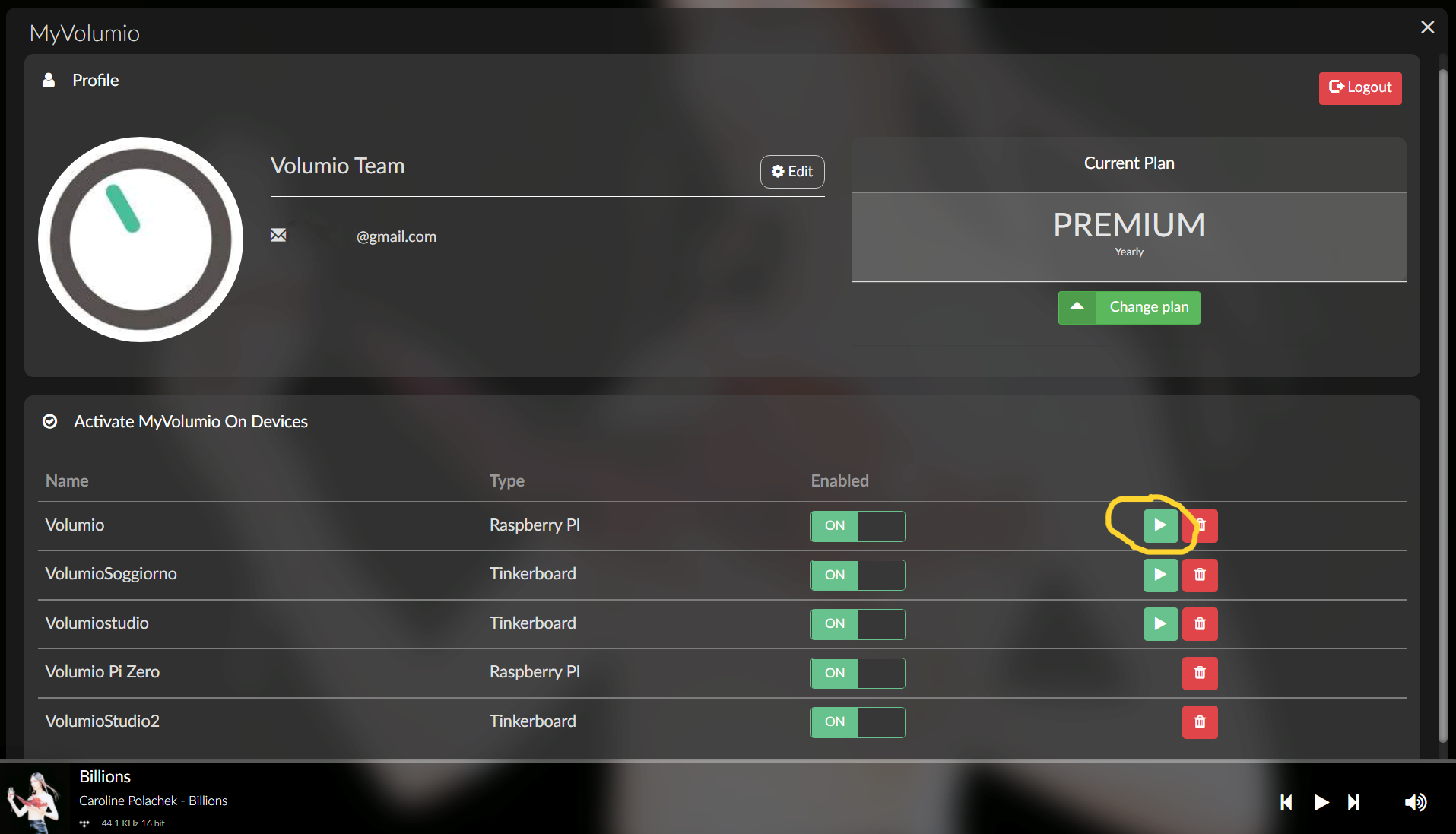

Check the ACCOUNT PAGE, the green play icon has to be shown next to the device’s name.
