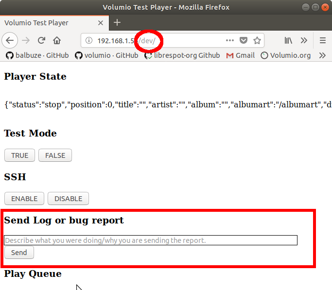

  • This will open the "DEV" page
  • Scroll until you see a section called "Send logs of bug report"
  • Fill the text field with a clear, but short description of your problem

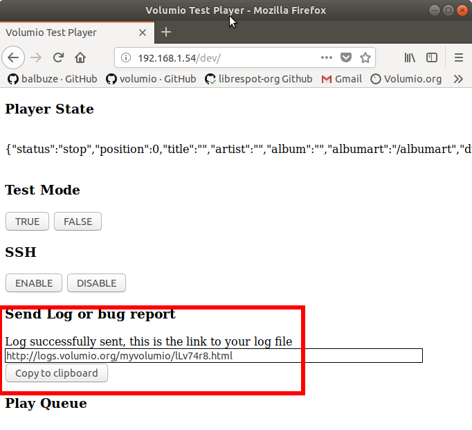

  • Click on Send
  • Once the logs have been successfully sent, you will see a link like "http://logs.volumio.org/xxxxxx"
  • Press the copy button to copy the link to your logs in your clipboard and use this link to add-on to yhe support ticket in the VOLUMIO HELP CENTER
